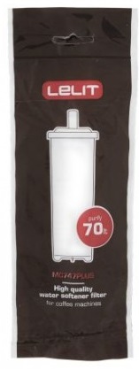

Pasados ya 4 meses usando la Lelit PL41 TEM me estoy planteando descalcificar ( he pensado mejor 3 al año que 2) pese a que tengo el filtro de agua que recomienda Lelit para 70 litros y en este tiempo creo que voy por los 35 litros usados (No sé si al tener el filtro me estoy pasando haciendo 3 descalcificaciones al año)

To avoid the formation of limescale, which can also deposit in the internal circuits, we recommend the use of our Lelit resin filter (code MC747 - MC747PLUS - not included) to soften the water. Please insert the filter in the tank following the instructions on the packaging. The filter purifies the water from the calcium and magnesium salts which are deposited to form lime scale and affect the taste of your coffee. Remember that the filter loses its effectiveness after a certain number of gallons treated, so replace it periodically. Instructions for the use and replacement of the filter are given on the box.
